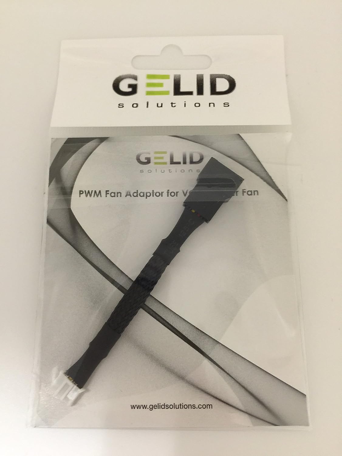

Hey
They do use generic fan connection (3pin). What i would recommend to everybody is to NOT run the fans with the included fan connection that connects to the AiO. You should try using a fan controller OR running push/pull straight from motherboard. This way you can create an elaborate fan profile that truly meets your expectations in terms of silent operation and actual thermal dissipation. In my case my mobo is a R5E so i have like 254 fans headers on the mobo so lol, i'll do it and report back. Still looking at fans though, can't decide. I probably will be going for 1xsp120 push and 1xaf120 pull. Anybody knows fans that would perform better in terms of sustained pressure in push and air flow in pull?

Hey
No the pump is connecting on the gpu pcb via a 4pin mini gpu header if i'm not mistaken.

Thanks. I'll plan on leaving that alone then and just hooking the 120mm fans up to the fan controller.

I'm getting great results with that setup and it looks good... highly recommend it. Update on my OC... I'm using a custom BIOS found on overclock.net with a 425W power target. It's being a pain in the butt. So far I'm running mostly stable... at 1506 core and 7800 memory on both cards with 1.205v and 1.218v. I was trying to hit 1525+ on the core, but even with volts to 1.240 or so, I crash. It may just be one card, or I may need to get even higher voltage. Temps only hit about 54 degrees under a heavy load (BF4 uses the GPUs very well - 4K @ 120% SSAA and 2x MSAA, fps uncapped I get about 100-110 FPS). But I usually play with V-Sync on, or capped FPS depending on the game. Power draw with this setup... whew, under full load the cards hit up to 84% power target (of 425W) pushing 360W.
