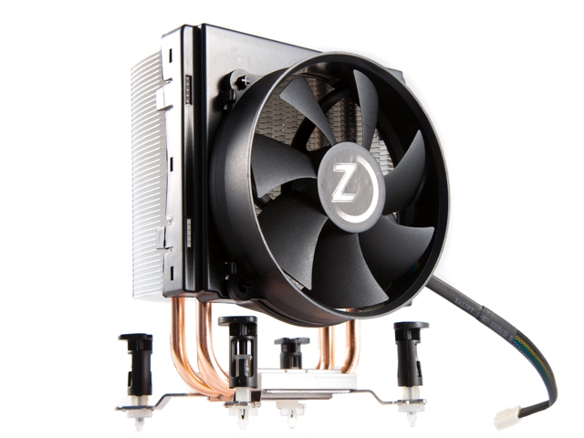

    Very Very highly doubtful that it will, that cooler stretches across the entire motherboard almost and looks like it would hit the side panel of the case.
    example picture:
    It's reasons like this is why I use the rosewill cooler on mine, plenty space around the socket, clears all the ram slots, and nowhere near as tall to hit the side panel
