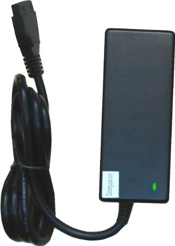

Johnny_Utah
Just figured I would add something here.  This is something that no water cooler should be without:
Plugs right into the wall and has a molex end to plug into your pump.  Best 15 bucks spent in years:)
http://www.amazon.com/Coo...-Adapter/dp/B000MGG6SC
What is this used for?  Leak testing?  Instead of hard wiring your psu you plug this into your pump instead?

Re:Water cooling guide for noobs 2013/02/24 07:43:33 (permalink)
Yes, when you are leak testing and bleeding the loop you want to run only the pump, so in most circumstances, you end up jumpering the pump via the 24 pin plug from the PSU, this way, you plug it into the wall and bypass messing with a power jack on the PSU.
Necessary?  Definitely not.  Makes life a LOT easier in the beginning oh definitely!  Worth the 15$, IMHO, yes, sometimes convenience is worth it.

Thanks for your tips, here is what I have come up with for my Water Cooling System.
Bill
