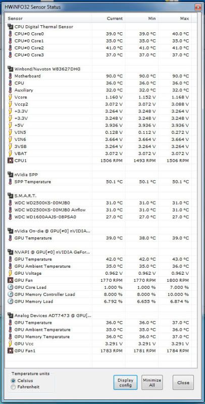

    What's a good program to monitor my PSU voltages? I just downloaded Speed Fan and it shows 3 voltages. Vcore is 1.22v, +12v is at 10.14v, and AVcc is at 3.25v. Any help at all?
    Edit: Also Speed Fan shows my System temp at 92C. What is this and is this a normal idle temp?
    squall-leonhart
    • Total Posts : 2110
    • Joined: 2009/07/27 19:57:03
    • Location: Australia
    • Ribbons : 7
    Re:GTX 480 SC Crashes While Gaming 2010/08/27 01:56:50 (permalink)

    danno428cj
    • Total Posts : 1045
    • Joined: 2009/07/24 15:25:33
    • Location: Canada
    Re:GTX 480 SC Crashes While Gaming 2010/08/27 05:24:10 (permalink)
    your +12v is only reading 10.14? is this correct?
    it should be above 12 volts

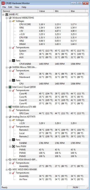

    squall-leonhart
    • Ribbons : 7
    Re:GTX 480 SC Crashes While Gaming 2010/08/27 05:44:05 (permalink)
    it should be anywhere between 11.40v and 12.60v when the +-5 is taken into account.
    Any lower, or higher is outside of the ATX spec.
    grab CPUID HWMonitor or HWInfo32, the voltages in speedfan are wrong alot of the time.

    helmutcheese
    • Total Posts : 1027
    • Joined: 2009/12/01 11:11:52
    • Location: Glasgow, UK
    Re:GTX 480 SC Crashes While Gaming 2010/08/27 06:11:46 (permalink)
    FGS do not go by software its only there for a reference and can be a mile out.
    Buy a $10/£5 Digital Multimeter and read those Rails on that PSU and see if it really is 10.14v or not, if it is that is too low.

    Reignfire
    • Total Posts : 71
    • Joined: 2008/05/13 11:39:04
    Re:GTX 480 SC Crashes While Gaming 2010/08/27 07:56:53 (permalink)
    Here's what I got from those programs. Are you sure it's my power supply and not something less costly to fix? Other graphics cards in the past worked well. Did they just require less power (9800GTX for example)?

    In the bios it shows the +12v rail as being 12.17v. Is it common for this to be different befor eand after all the devices boot up?
    #29
    helmutcheese
    Re:GTX 480 SC Crashes While Gaming 2010/08/27 16:32:40 (permalink)
    I have said before above, software can only be used a a reference.
    You need to test it with a Multimeter or your simply wasting your and  everyone else's time after reporting that low 12v Rail above.
    And YES the voltage will be lower in Windows that in Bios and lower again under Load unless your Mobo has circuitry to prevent this.
