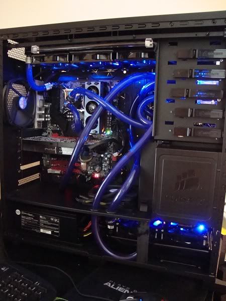

So I have been building this PC for awhile now and have created one off threads here and there, but I think it is time to consolidate my build into one thread that can grow as my systems reaches its final destination. So with that I would like to share my build with you and see where it leads me in the next few months.
Full Build Log - Corsair Obsidian 800d Dual Loop System all within the case
Current System Specs:
PC Setup:
CPU: Intel Core i7 920
Motherboard: EVGA X58 E760 Classified 3-Way SLI + PhysX
Graphics: EVGA GTX 470 for PhysX (waiting on HC FTW 480's)
Memory: Corsair XMS3 6GB (3 x 2GB)
PSU: Silverstone 1500ST
Case: Corsair Obsidain 800D
Hard Drives: OCZ Vertex 60GB & OCZ Vertex 30GB - 2x WD 150GB Raptors
Operating System: Windows 7 Ultimate 64bit
Items On Order:
Graphics: 1x EVGA GTX 480 HC FTW (Was only able to get 1 this week, will order #2 once the next wave is available
GTX 360 Rad + fittings and mounting for outside of case install
My Build Guide:
As big as the Corsair Obsidian 800d case is, it is just not meant for a massive dual loop system built inside the case. I am not a big fan of huge radiators hanging off the back of my system so I did a few mods to allow a GTX 240 Radiator fit in the lower level of my case. While the system cools my components well, the overall look is not so pleasing with that big MCP665 right in my side panel window.
So I am now in the midst of redoing my water cooling layout to remove that 665 from the window so I have a direct view of the components that matter. Here is an image of my system in its current state, Tubes all over and some new additions from my original build.
I will be starting to build out my system to mount a 360 rad on the back side to bring temps down overall while under full load. Look at my below post for the new layout & any input or ideas are more than welcome.
Also I have hired Crys1s from the forums to help me dress up my cabling with some Black and Blue highlights
Update: 9/21/2010
Here is some final shots of how my system looks today. It has gone through some buig updates and changes from the above, but I am happy with the final break down.
post edited by sledgehammer70 - 2010/09/21 19:14:54

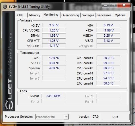

    Re:Project Sledgehammer - The Build That Never Stopped 2010/04/19 15:30:35 (permalink)
    Is this even right? I got my new 980x and the idle temps on the chip are 15c cooler than the i7 920. Did I just not have the block installed properly on my 920? or does this chip just run that much cooler?
    Thanks
    Sledgehammer70
    Clergy
    • Total Posts : 2296
    • Joined: 2008/12/27 14:45:40
    • Location: In A "Texas Flood"
    Re:Project Sledgehammer - The Build That Never Stopped 2010/04/19 18:11:36 (permalink)
    sledgehammer70
    I'm pretty sure its just the fact that the 980x is a 32nm chip and the 920 is a 45nm chip. That's why you are seeing such a decrease in your idle temps; awesome seeing 6 core temps in e-leet, haha
    sledgehammer70
    • Total Posts : 1052
    • Joined: 2005/10/26 10:02:14
    • Location: Temecula, CA
    • Ribbons : 11
    Re:Project Sledgehammer - The Build That Never Stopped 2010/04/19 19:44:28 (permalink)
    Clergy
    I knew the 32nm chips ran cooler... but 15c? That is a big drop. I have been playing around with it and have her running at 4.4GHz and have yet to see any of the cores rise above 38c idle.  On my 920 the cores would be in the mid 40's at 4.2GHz at idle.
    Also under full load the chip has not gone over 63c... seems to me this chip has a lot more head room maybe 4.6Ghz+?

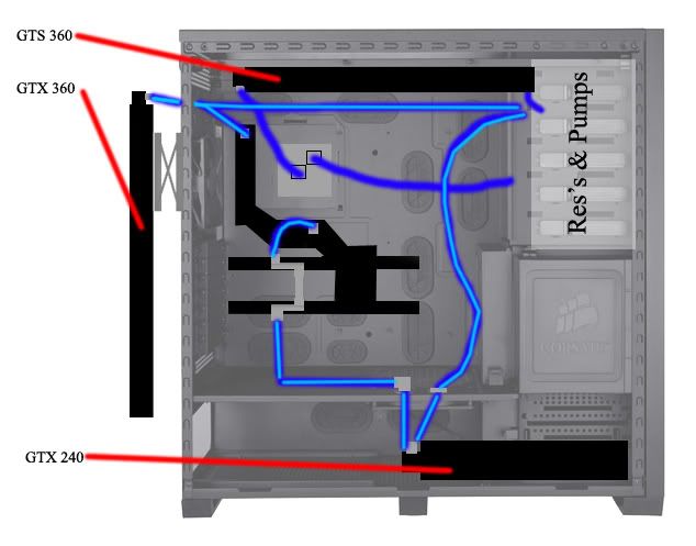

    Re:Project Sledgehammer - The Build That Never Stopped 2010/04/25 22:26:27 (permalink)
    I wasn't planning on ever moving a rad outside of my case, but with the prospect of adding 3 GTX 480 HC FTW card I want to start figuring out what would be the best flow for the build.
    Here is a flow layout & a plumbing layout, any suggestions are more than welcome. I am not happy about having to port this outside of the case, but I have no other options.
    Just so you know I am using a 665 pump with speed control so I don't think overall flow would be an issue with the 2 rads...

    Re:Project Sledgehammer - The Build That Never Stopped 2010/04/25 22:44:10 (permalink)
    Here is the list of components I will be using for the new additions... I did my best to pick out parts that would last and carry over to any future builds.
    Black Ice GTX 360
    Koolance Rad Mount
    Koolance 140mm Mount adapter (I got this so I can keep my current fan in place)
    Scythe SFF21F 63 CFM S-FLEX x3
    Misc fittings to match up the new layout
    The biggest thing i am also doing is moving the Chipset to the GPU loop so the CPU is on its own dedicated loop. Not sure if this is the best idea, but any suggestions are welcome

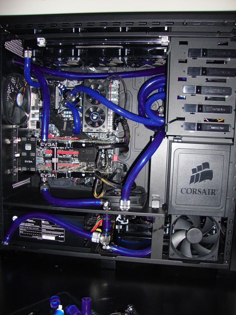

    Re:Project Sledgehammer - The Build That Never Stopped 2010/04/28 23:03:23 (permalink)
    Adjusted some of my tubing routes and added in my 2nd GTX 480 HC FTW. I decided to keep the chipset on the CPU loop for now.

    Re:Project Sledgehammer - The Build That Never Stopped 2010/04/29 13:28:51 (permalink)
    Update: I have finally finished my build! well minus the 3rd GTX 480 HC FTW & cable sleeves, but that will come down the road once I save up a lot more pennies.
    GPU temps now sit at 34c idle and hit 43c under full load. The loop is performing very well, and I like to think it cleaned up very nicely over my original layout.

    raw2dogmeat
    Hey Sledgehammer70, looks great! I have a question for you. Is that the Koolance rad adapter on the back of your case? If so, how did you still mount a fan on the inside of the case?...maybe I'm missing something, but I just bought one, installed it, and don't see how to continue using a 120mm fan on the inside WITH the Koolance adapter in use. I hope to have my updated pics by Sunday with sli'd 480's and Koolance blocks...too tired today!!
    You need to get the 140mm adapter. The 800D case has mounts for a 120mm fan and a 140mm fan. I used the 140mm holes for the bracket and the mounts for the Koolance device only need to screw in from the front allowing the case fan to stay in place.
    Thanks
    Sledgehammer70

    Cables are done being sleeved.. just waiting for them to arrive to install them.
    Thanks
