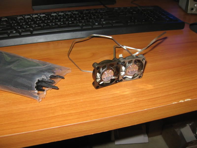

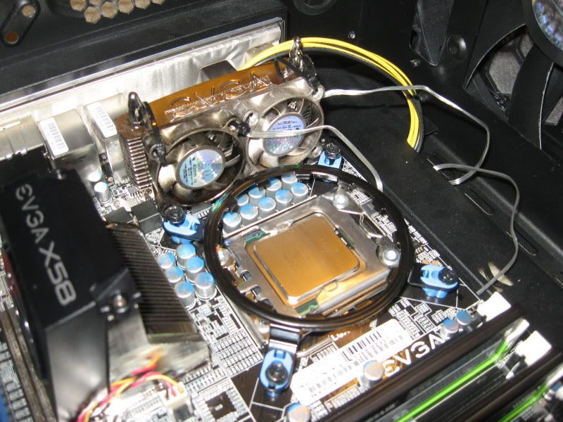

lol Halloween, all you really need to do is replace the default thermal pad with the EK 1mm and you're good to go. The VReg heatsink comes with two pieces... the tall heatsink itself, and a long clip at the bottom to hold it in place. Put some AS5 between the heatsink and the clip and it should drop your temps by another couple degrees. I also put 2 x 40mm fans on it, ziptied them together then ziptied them to the heatsink:
