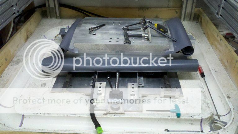

I have been such a slacker, and I never posted the build log to the CNC that I currently have running right now.  Keep in mind I have been working on this build for OVER TWO YEARS, so this is just a few of the pictures along the way.
Having a home made CNC comes with its perks, and drawbacks.  First, just having a CNC is its own perk.  The biggest drawback, is the constant repairs to it.  Building my first one, I didn't give too much thought to future maintenance.  It would break down more often then I liked,  and the accuracy could be improved with different technologies.  Also the workload was picking up drastically and the small machine could only cut one side of a block at a time.
The decision was made to build a second machine.  This one would have none of the shortcomings of the first, and I used something that professional CNC machines use... Linear rails, not dovetails:
Fast forward a year, and then I have a semi-working table:
with a 50lbs 6" vise sitting on top of it.
Starting to build the gantry, or frame for the machine:
The Z axis plate:

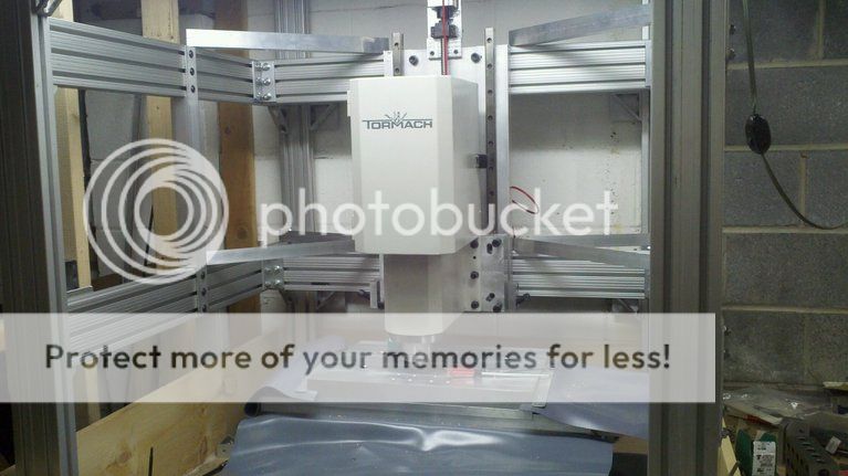

And the professional quality Milling head that would be the heart of it all:
The table test fitting in the initial frame:
cable works:

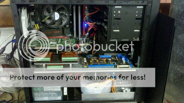

The brains of it all:
The Z axis test fit:

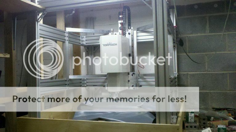

Z axis mounted:
All the way down:
and ALLLLL the way up:
All 18" of Z.
The gutter being fitted:
Concrete Pour:
The resin, and sand mixture over the top:

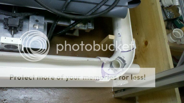

Recirculating drain system:
Lights:
Coolant/air:
Tool Plate:
Annddd... bellows:
That was all she wrote.  Then I started the first fixture plate which is how I make batches of blocks:
Now, this is just a brief touch of the pictures I took over the 2 years to make this machine.  The larger parts I had to farm out to shops to surface finish, but everything else was made in house with the first CNC.  Everything was easier having an already working CNC to make the second one.
Now the best part... I am building ANOTHER CNC to replace the original one.  Building another machine is easier when I have this machine I posted here to help me with that process.  Every mistake learned, is fixed in a new machine.  I don't know everything, but what I wish I would have done, I do in the next build.
Some have asked, if its cheaper to buy one.  The answer is sort of yes, and no.  If you look at the amount of cubic workspace of a machine that does 18x18x18, some cost much more, while others are far less.  Most CNC's have a huge X axis, and MUCH smaller Y axis.  I don't need 40" of X, and 9" of Y.  Of the batches I do, most work is done from square stock, so it made the most sense to have a large square work envelope.  Also, the experience of building it pays off with the experience.  You learn so much about them making them, that you wouldn't just buying one.
In any case, the machine performs as I always hoped it has.  Hope you guys enjoy the read, and I didn't set anyone's dial up modem on fire. :)

    Ive looked at Tormach milling heads before, great choice
    The motor drives look like G203v's, but what type pf breakout board did you use?

    Is that being controlled by your original X58 Platform?

    Thank you all for the kind words!  i will try and answer everyones questions.
    Yup, 203V's and the C11 BoB.  Yes... its PAINFUL how much work it took.  The next build I am working on as we speak.  Sizing up motors (probably a 2HP 56C style, and a 2HP Sensorless Vector drive from automation direct).

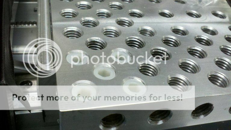

    The white nylon inserts just were to keep junk out of the threads.  They didn't work out so hot. Its such a pain to remove chips from ALLLLL those holes.

    Yup...the X58 Micro is running it all! :)
