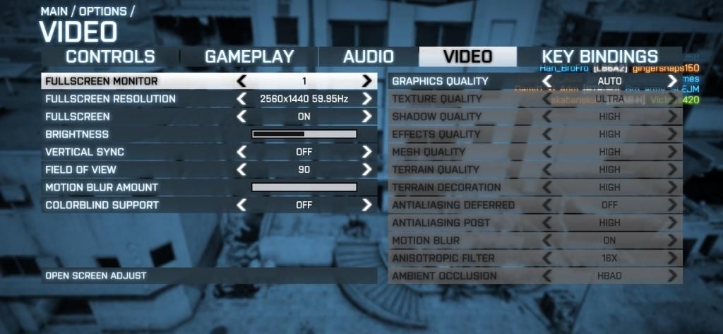

    Re:BF3 Constaly Crashes - Please Help - GTX 580 SLI 2013/04/29 21:32:47 (permalink)
    Well that is your problem right there...
    Running 2560x1440 with completely incorrect graphics settings, totally wrong FOV -and- HBAO enabled
    Setup that way, its no wonder that Battlefield is having serious problems as you only have 1.5gig VRAM GTX 580's
    This will be a easy fix indeed
    Not only will the game stop crashing once we get the settings correct, its going to LOOK alot better and performance will increase
    OK the very FIRST thing to change is the FOV, as your running it way way to high.
    *remember you have higher pixel density at 2560, but its aspect ratio that you match horizontal FOV for in BF3.
    A 90 FOV value and the "ultra" texture quality setting along with HBAO, is what is CAUSING your problems!!
    -->Change the FOV to the default value of 70, as that is the correct value for your monitors aspect ratio
    Next up are those terrible video option settings
    -->most yucky for image quality and causing crashes (along with the FOV you had)
    Please use the -exact- settings posted below for testing (starting with CUSTOM) and dont skip any
    *Remember, after making the changes above you MUST save them -and- then quit the game completely, close Battlelog and close Origin. Then restart Origin so that your "new" settings are correctly sync'd and the shaders can rebuild correctly when you next join a game.
    You will find that with such a nice monitor, the suggested settings I posted will look WAY better and your performance levels will improve.
    It also should FIX most if not all of your crashing issues

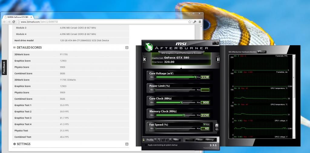

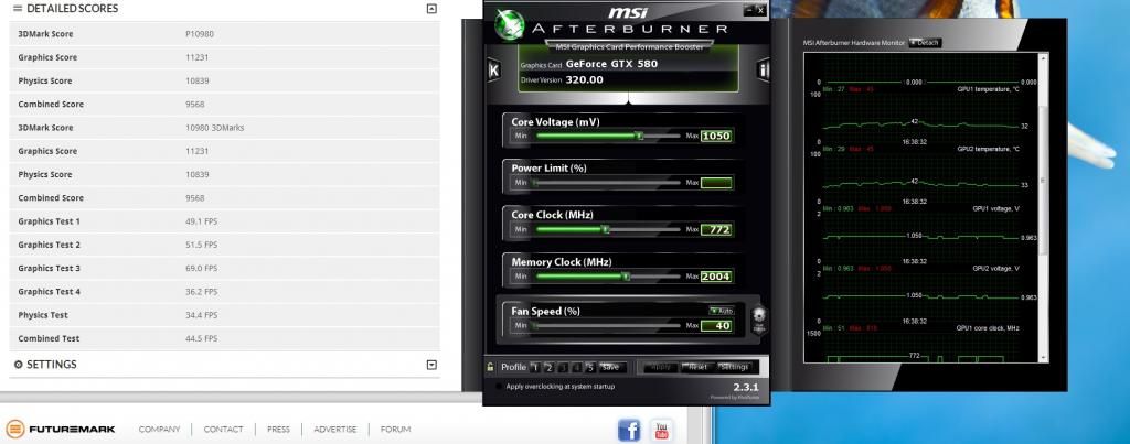

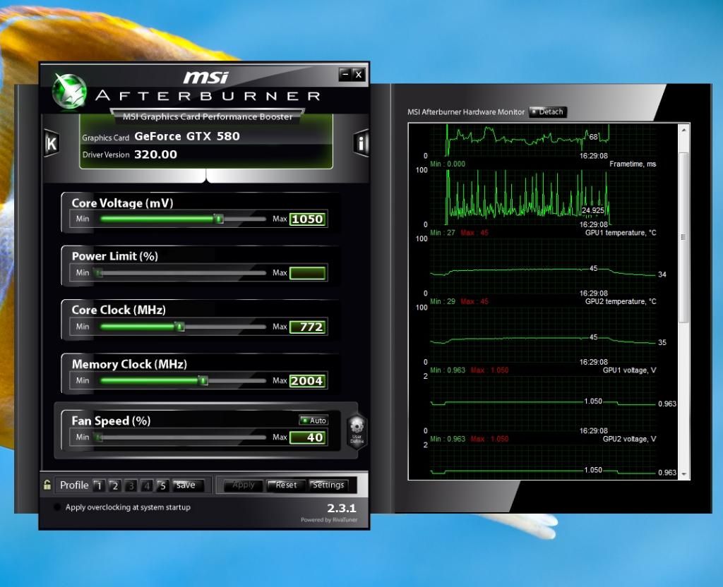

    Thanks for the help Maniac!  I changed the settings and gamed for a bit this morning.
    1st attempt:  Stock CPU/GPU clocks and voltages -- 5 minutes in, hard lock, black screen crash with looping audio playing just after the crash until the entire computer freezes.
    2nd attempt:  Stock CPU/ GPU voltage bump (1.063 vrs. 1.050) w/ 132.00 (cards syncd' in Afterburner)  -- played multiple rounds, no crash yet.  Aprox 45 minutes of gaming.
    3rd attempt:  OC CPU / GPU w/ voltage bump & 132.00 -- stable for 35 minutes of testing then had to quit.... more testing tonight.
    It seems my cards at stock voltages are causing a hard lock, black screen, freeze than crash in bf3 with any driver.

    Re:BF3 Constaly Crashes - Please Help - GTX 580 SLI 2013/04/30 10:00:56 (permalink)
    I would like you to head on over to my 500 series overclocking thread...
    http://forums.evga.com/fb.ashx?m=1866518
    Please perform the -stock- testing as posted, and report back your results
    *BEFORE starting on the testing, please uninstall Precision (and answer -NO- when asked to save data and profiles) and REBOOT once (do NOT skip this reboot)
    Then use the Afterburner 2.3.1 version linked in the thread with the -exact- setup and settings as suggested for the testing

    Here are some results at stock clocks on my GPU.  The processor is overclocked to 4.4ghz.
    Listed below are the two 580's and some specs I found in AB:
    EVGA Vanilla -  - 1.050v - 772/2004- max 1.138v
    Zotac Amp - 1.000v - 815/2050 - max 1.115v
    All test are done with cards "synced" in Afterbruner 2.3.1

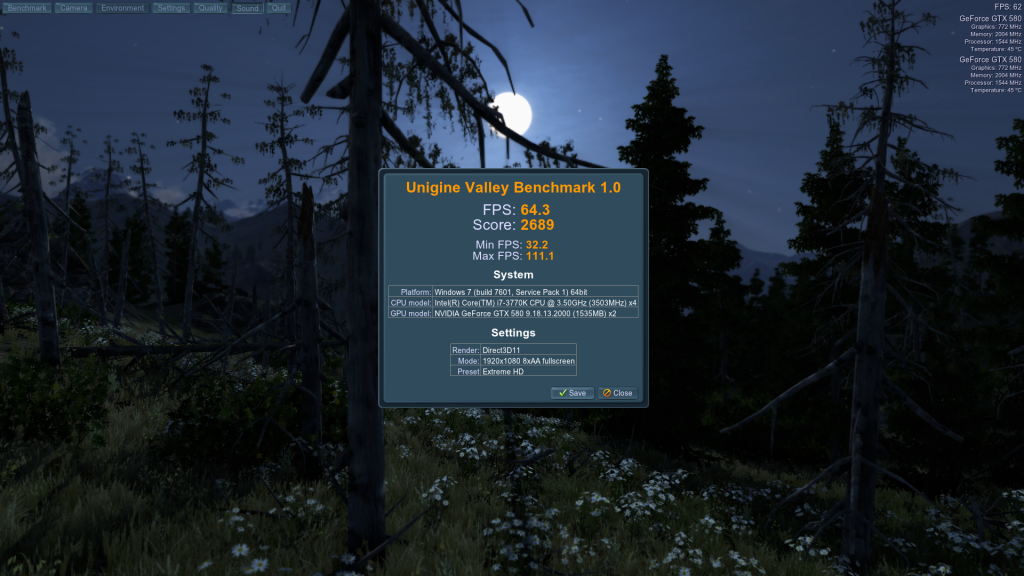

    Valley Benchmark Results:
    Valley Benchmark Temps:
    3dMark 11 Results and Temps:
    Max GPU temps- 45c both tests
    3dMark score: P10980
    3dMark11 w/ stock CPU clock + GPU overclock:
    Max temp GPU: 46C
    Clock speeds: 900/2150 @ 1.138v
    Score: P11795
