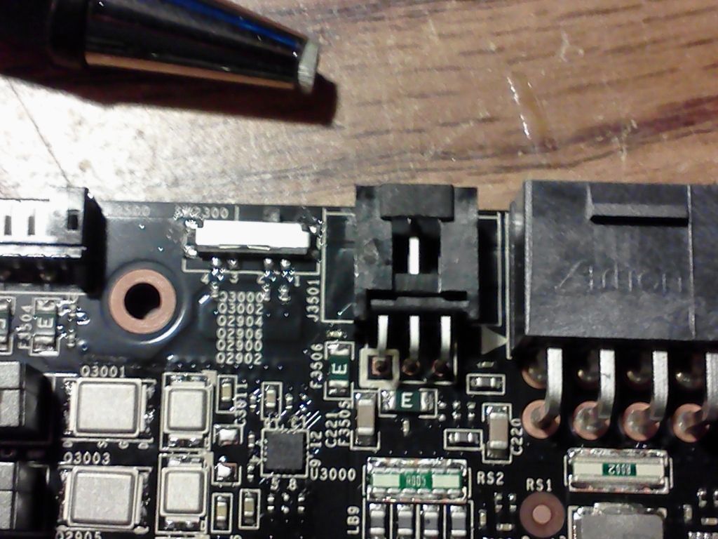

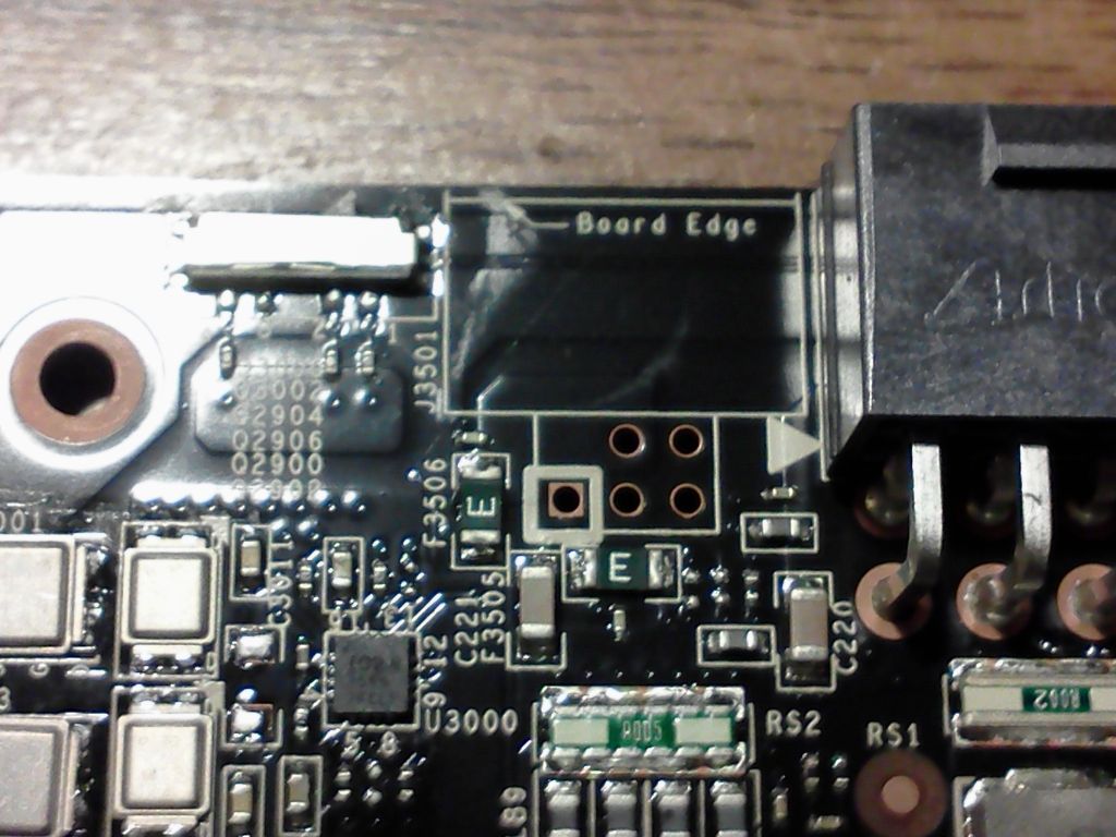

Before:
After:
Total cost, ~$2.00
I used Digikey PN - WM8261-ND
any 6 pin with 2.54mm spacing will work after removing one  pin.
Results:
EVBot works great with this mod, which shows that all that's missing now is the connector itself.  * view post #12 below

    deftonesmw
    • Total Posts : 96
    • Joined: 2009/12/01 06:30:18
    Re:680 Classified, the way it should be! 2012/10/20 13:33:54 (permalink)
    I can confirm that all it took was soldering the headers on.  My evbot communicates fine.  I programmed my evbot through one of the cards and can adjust values at will.  I get the OK! when i make a change so all is well.
    I used Digikey PN - WM8261-ND as that's what i had laying around.  Pull one pin and you're good.
    Tommorow i'll push these things and see what i can get out of them

    Any news on this? What's this part that was put in and any DIY guides? How did the testing turn out?
    deftonesmw
    • Total Posts : 96
    Re:680 Classified, the way it should be! 2012/10/21 13:01:37 (permalink)
    myatan
    Go up about 4 posts, i have the PN from digikey in there.  I'll update the op to make it easier though.

    myatan
    • Total Posts : 75
    • Joined: 2005/10/18 18:28:15
    Re:680 Classified, the way it should be! 2012/10/21 13:20:15 (permalink)
    How do you insert it? And also how do you remove one pin? Any other tools required?
    deftonesmw
    • Total Posts : 96
    Re:680 Classified, the way it should be! 2012/10/21 13:55:33 (permalink)
    myatan
    You just clip the back side of the pin and pull it out the front of the connector.  Then clean the points on the board and solder the connector in.  The only thing left for me to do is verify the voltage changes on the hardware level via a multimeter.  The EVBot shows successfull changes but it's not showing the voltage in precision or oc scanner.  This is my first time using an evbot so i'm still learning.  Anyone have any input on how to verify voltage via software?

    Took me about 12 minutes to do this mod on my 4 x Classifieds (That is with the soldering iron heating up) - Yes, even a child could do this (Or at least a person that read a simple soldering guide).
    Remember:
    Lots of light, and if possibly a magnifying glass (Makes the job so much easier).
    Good soldering iron (Not expensive, just with an adequete tip - Most soldering irons (30-50 USD) comes with a perfectly fine tip for standard soldering)
    Steady hands (No-one shouting around you that dinner is ready)
    You can *always* use a solder pump to undo a solder
    ground yourself!
    And NO, you do not have to do it in 12 minutes - I was only able to do so as I been soldering for years and have a workbench for it. Take it slow, do one solder at a time and look it over -
    DO NOT EVER SOLDER TWICE TO "TRIM" the soldering, this WILL make it messy! If you solder is "imperfect" just heat it up and use your pump to remove it - Then redo!
    And remember - You are NOT supposed to heat up the solder itself, but the object you are attaching the solder too. I seen countless of ugly and loose soldering, all because the person doing it was heating up the solder itself!
    My only problem now is what to do with the 196 EVBOT ports I still have - I ordered them from China, through Ebay, and they only had them in a package of 200 - Paid 25USD for them (With free shipping).
