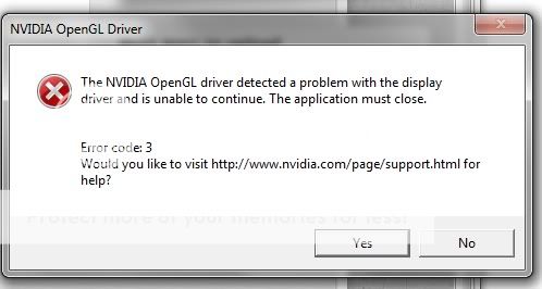

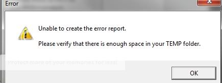

    Im gettting the same thing and ontop of it,. Also getting opengl errors:
    right after that:
    I was working in Sketchup when the above pics. Has happen more than a few times.
    I have tryed:
    285.62
    280.26
    275.33
    I ended up going back to 266.33, I was trouble free for 7 months, and Sam3 wanted a newer driver. I work more than I play. This driver crap keeps going, I might go back to Quadro's and get a Xbox360. This was the very reason I quit buying ATI(AMD) GPU's
    Im loyal to EVGA, not Nvidia.
