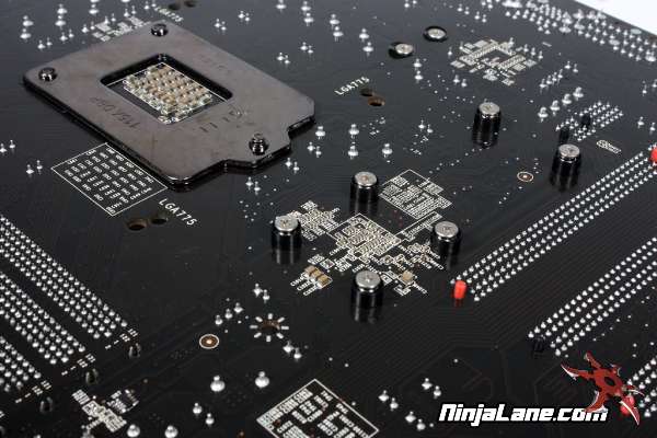

    I discovered one problem though ... it seems that XSPC RASA CPU backplate will NOT fit the Z68 motherboard ... need to contact FrozenCPU, maybe I will be able to swap this block (paying the difference and shipping only) with Raystorm block which has 100x better backplate ...
    RASA block backplate, no way it fits Z68:
    Raystorm block backplate, should fit easily, opening in center is huge:
    back of EVGA z68 ftw board (not my pic):
    post edited by feniks - 2012/05/02 13:18:57

    loveha
    • Total Posts : 9917
    • Joined: 2009/09/26 01:51:22
    • Location: Beulah Michigan
    • Ribbons : 53
    Re:First water loop diagram (with XSPC kit), is it any good? 2012/05/02 14:01:15 (permalink)
    feniks
    thank you! My room ambients are pretty high as for NJ ... in Summer 27-28C is rather normal in my apartment, even with AC on during the day ...
    I don't see what the issue is. The back plate normally lays on the CPU Socket retention plate. Unless there is something else I am missing.

    Re:First water loop diagram (with XSPC kit), is it any good? 2012/05/02 14:08:02 (permalink)
    loveha
    there are 2 screws in top part of that retention socket and it seems they will be where the "arms" of backplate should be in top portion. the Rasa block backplate has no cutouts for such screws.
    on OCN I read that many people could not get this installed on different Z68 boards, because of this backplate problem issue. some resolved it by using Corsair H50 backplate (if they had it) ... some others used dremel to widen the backplate opening (kinda hardcore way to fix it LOL!):
    http://www.overclock.net/...240-360-kit-club/11220
    I actually am working with FrozenCPU on the swap, seems I will be going with Raystorm CPU block after all (while keeping other components same) even though I now have to cover shipping both ways. Raystorm is getting better reviews, anyways, so it might be worth it regardless
    EDIT:
    after I ship Rasa block back to FrozenCPU it will come down to $13 for the cpu block upgrade (vs Raystorm Acetal) plus around another $13 for shipping both ways. Excellent customer service in FrozenCPU!
    post edited by feniks - 2012/05/02 14:42:30

    Re:First water loop diagram (with XSPC kit), is it any good? 2012/05/03 18:22:07 (permalink)
    OK, received the kit today. apparently the RASA block mounting backplate in above picture is not for 1155/1156 ... the one shown above is for 775! hence why it wouldn't fit
    here is a picture of all 3 intel backplates for the RASA block (from left to right actual block, 775 plate, 1366 plate and 1155/1156 plate on right, on top is AMD hardware kit):
