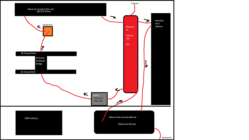

If any of you guys have experience watercooling and running loops I sure could use some advice.
The parts are pretty much as labeled except I have an extra EK Revo D5 pump in my possession.
Not sure if the order of tube to rad to block look right. I would have preferred to have one rad
in middle of cpu and gpus but that would create more tube length and insanity. What do you
guys think?
Thanks

I like this better not sure what you were doing with the bottom rad in your layout but loose the xflow up top make all rad push except bottom monsta go push/pull.
Off to watch football now but I'll be back because I have quit a few question not least of which is case.

Thanks for the corrections. Looking up restriction data info and it seems that the AlphaCool and SR-2 are both 0.13 and the 360 GTS XFlow is 0.91 and the Heatkiller is at 0.85. Not sure what the restriction values are for the EK Classy KPE blocks. Anyone know?
Also not sure if I can run a terminal bridge off of the Classy KPE 980ti Blocks? The EK specifications and warnings are confusing.

Not really a Correction, they say you can go anyway.
I like to have a Rad to help cool down the Coolant before it goes back into the Pump/Reservoir is all.

Also I like the coolant coming from Rad to the Water Block then from the Pump as the Pump can heat the Coolant.
If the Classy KPE 980ti Blocks are from EVGA (Hydro Copper) even if made by EK you Cannot use the EK SLI Water Block Bridge.

dmoheban
My blocks are made by EK not EVGA.
Thanks for the suggestions.

Why would I not need a flow meter? And aren't having both together redundant?
Thanks
