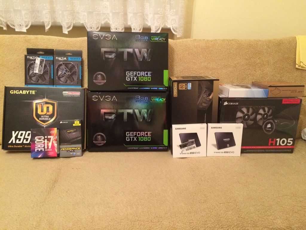

Hey there, new member here. Proud owner of 2 GTX 1080 FTW as well. I bought them - funnily - exactly on 31th of August.
I just found out about this unfortunate issue. Very nice of you to provide solution. I would be interested in getting these additional thermal pads, just to be on the safe side. How and where do i "sign" for them? I live in Slovakia and i bought the cards from local reseller (). Should i contact them or should i deal directly with you (Evga?) I dont think you have any official representation in my country and never dealt with similar problem, so any advice how to approach this situation would be appreciated.
Many thanks in advance.

Welcome to the Forum Timmaigh
You may want to create your Own Thread under EVGA MODS RIGS and post you Build or Assembly and create a of your own and maybe win a 1000 EVGA Bucks.
