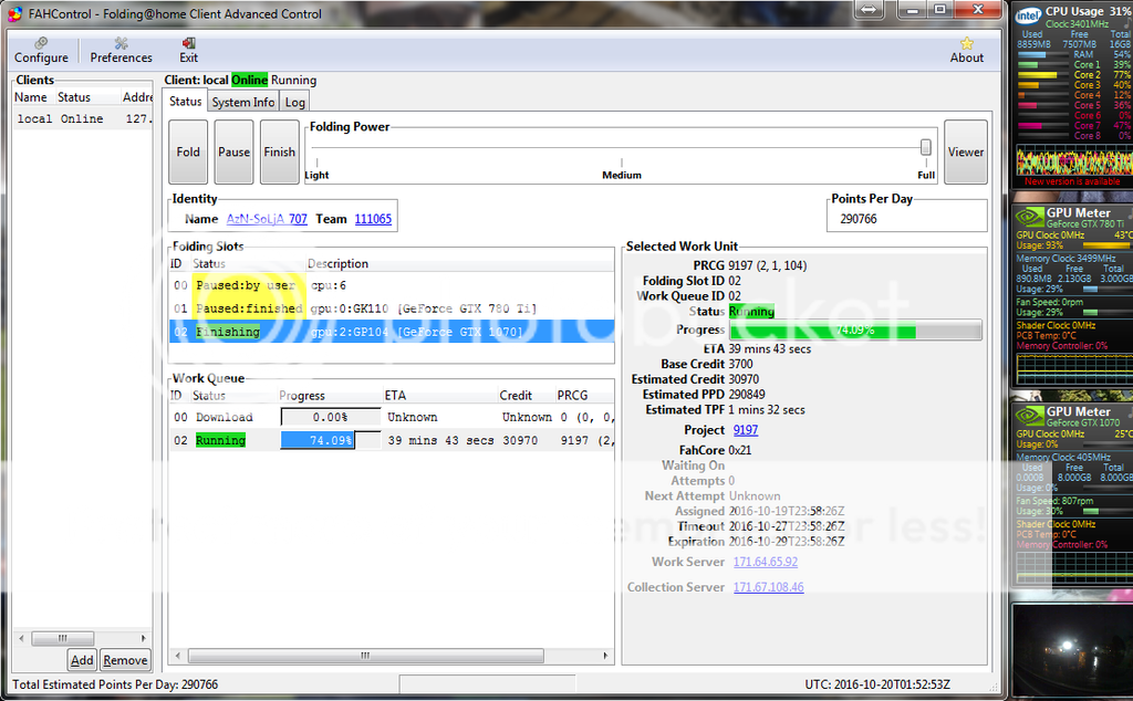

    Another issue, FAH recognized the wrong gpu's names
    1070 finished first as you can see utilization on the right.

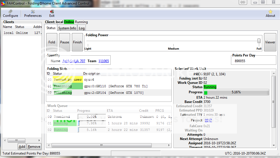

    I've just PM'd this info to AzN-SoLjA (he PM'd me about this issue yesterday).
    I've also had mixed up GPUs some time ago and could resolve it by using this guide:  GPUs mixed up
    I also noticed from your screenshot that your first GPU (780 Ti) is gpu:0 and your second GPU (1070) is gpu:2
    So there is no gpu:1 , which is probably listed in your "System Info" tab as  GPU 1: UNSUPPORTED: NV3 [PCI].
    So you probably will see this as your GPUs listed in your System Info:
    GPUs : 3
    GPU 0: NVIDIA:3 GK110 [GeForce GTX 780 Ti]
    GPU 2: NVIDIA:5 GP104 [GeForce GTX 1070]
    This "UNSUPPORTED: NV3 [PCI]" seems to be an error from FaH when you install a Pascall card (I have this also with my 1070), so be very careful when you are going to manually select your  opencl-index and  cuda-index fields.
    Or don't change it and try to remember that the cards are mixed up (also because if you install new drivers the GPUs position could change again).
    post edited by DutchForce - 2016/10/20 05:49:58

    AzN-SoLjA
    • Total Posts : 7762
    • Joined: 2011/06/18 11:45:02
    • Ribbons : 13
    Re: What's this folding error? 2016/10/20 09:03:08 (permalink)
    Makes sense, I'll give this a shot today.
    I used to run the cpu randomly from time to time, but I honestly haven't used it for a long time and left it sitting there.
    I reinstalled everything new, guess it readded it automatically but I don't plan on using it as it will heat up my water loop connected to my 780Ti pretty quick lol.
    0 and 2 is what works, 1 appeared to be something else. Probably my sound card for all I know or some reason its still seeing my old 560 somewhere. About to run them shortly.
