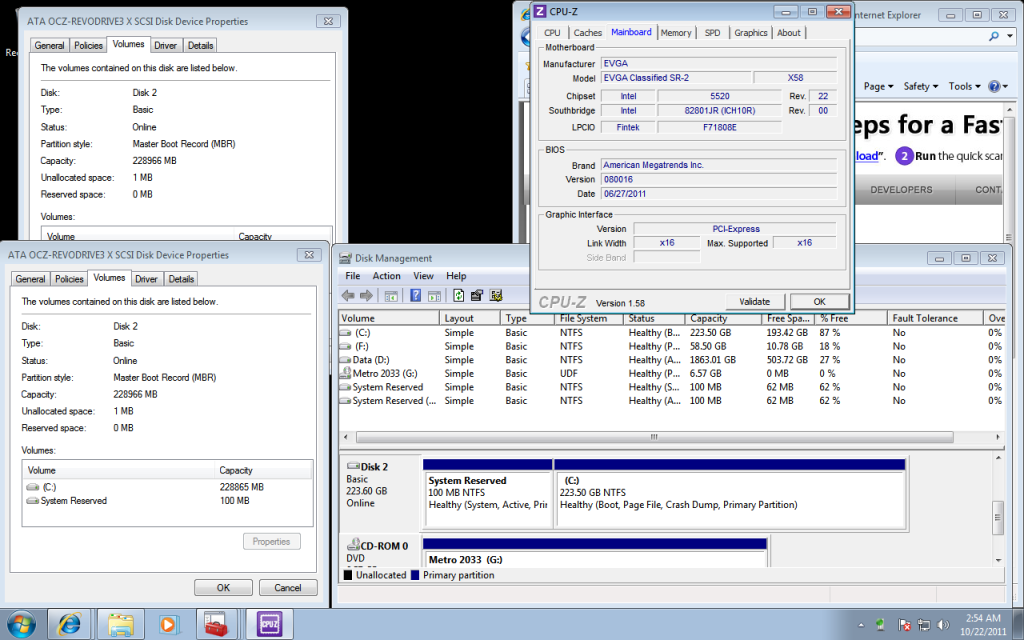

Re:Revodrive 3 X2
2011/10/21 23:17:51
(permalink)
Well, only one way to find out. I'm going to load up the latest OCZ firmware and give it a go. I'll post back with results shortly. UPDATE: Holy Crap. I just booted the OCZ BIOS and no 0085!!! Now let's see if this bad boy is bootable! I'm going to give installing Windows 7 a go. More to come. UPDATE2: I'm so excited I can barely type. Proof is in the pictures: Yes! My Revodrive 3 X2 240GB now functions properly as a Windows boot drive on the EVGA SR-2! I imagine it will take some time for this new BIOS/Firmware combo to make it through the supply channel, so you will need to first deny the drive option-ROM space (if using an SR-2 for the update), update it, then start working with it. So if you already have a working Windows install, then: 1. Load Optimized defaults in the SR-2 BIOS, power down, physically install the Revo. 2. Install the lastest drivers within your working Windows install. http://www.ocztechnology.com/drivers/RevoDrive_3_and_RevoDrive_3_X2_/ 3. Grab the latest OCZ toolbox. http://www.ocztechnology.com/ssd_tools/OCZ_Vertex_3,_Vertex_3_Max_IOPS,_Agility_3,_Solid_3,_RevoDrive_3_and_RevoDrive_3_X2/ 4. Update ONLY the firmware using the OCZ Toolbox. Reboot. 5. Update the BIOS using the OCZ Toolbox. 6. Reboot, and go into the SR-2 BIOS and disable some option ROMs to free space. (SATA3 Controller is an easy one). Make sure you can see the OCZ BIOS load. 7. Enter the BIOS again an select "REVODRIVE X" as the boot drive. Edit: If you don't have a working Windows install then follow the instruction's here: http://www.ocztechnologyforum.com/forum/showthread.php?89670-Tools-for-OCZ-SandForce-Driven-SSD-s to make a bootable linux USB drive that can update the BIOS and firmware. The process of enabling/disabling option ROMs are the same. Props to OCZ to making this a reality. Finally--a fast solid-state solution beyond the (mediocre) Marvel SATA3 controller for the SR-2. Apparently, this does not work. You have to update within a working Windows install.
post edited by tpb7463 - 2011/10/23 14:02:33

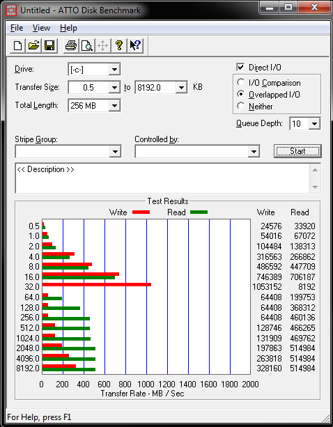

Re:Revodrive 3 X2
2011/10/24 15:07:30
(permalink)
Hmm... Better hold off for a bit. Something isn't right here. These numbers are terrible! Tested in Slot 5 on A54.
post edited by tpb7463 - 2011/10/24 15:09:41

Is that result reproducible? Your ATTO output looks just like all the published online Revo 3 X2 benchmarks up to 32 KB transfer size, at which you experienced some kind of glitch and then the drive recovers, but not fully. What kind of overall transfer speed does Windows Explorer report when you copy a large file from the Revo 3 X2 to some other location on the same drive? I'd be more worried about that, than any artificial benchmarks.
Re:Revodrive 3 X2
2011/10/24 16:32:32
(permalink)
lx_flier Try it on slot 1 if you can on some motherboards for this drive it makes a huge impact. Would if I could. My 590's are watercooled and I can't move them around at the moment. I tried the card in 5,6,7--all give the same miserable results. I even jumpered off my second 590--same thing. jabloomf1230
Yes, that ATTO is very reproducible. Every single time I run ATTO it backs off at 32kb. A major problem that I'm noticing is that no matter what kind of card config I use, I can't get the drive to report the correct PCIe bandwidth; which apparently is 5.2Gb/s. All I can get from the drive is 2.5Gb/s--OCZ claims that under this condition, the drive isn't getting the necessary bandwidth. My first impression that it's the card itself that's at fault; especially when I give it its own NF200. I paste-binned some "real-world" results using copymark: http://pastebin.com/Vu1GJrGZ Copy into a text editor and save as CSV then open in Excel to save your eyes. Each test would suggest that the drive is getting x1 (!) PCIe bandwidth. I'm not giving up yet. I want this damn thing to work as advertised!  Especially when I see this: http://forums.evga.com/fb.ashx?m=1260663 Like I said, something isn't right.

Actually.. its already kicking my array's ass before it farts out. 8's over 400mbs.. 16 is over 600mbs etc..
post edited by lollygag - 2011/10/24 16:59:15
Re:Revodrive 3 X2
2011/10/24 17:16:49
(permalink)
lollygag Actually.. its already kicking my array's ass before it farts out. 8's over 400mbs.. 16 is over 600mbs etc.. Well, the queue depths are different. I ran mine at 10 (per OCZ).
