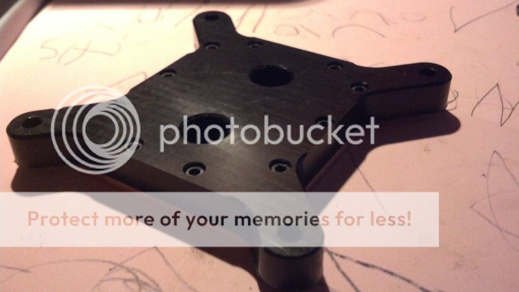

Going off the Stinger Block, this is a REALLY ROUGH draft of the CPU block.  Keeping it as true to the stinger format as possible, just simply based on this review:
http://forums.evga.com/FindPost/2267685
This is just a rough hand-jam @ work while I had a few minutes.  I was going to keep it a solid square just to make my life easier, then I realized base on the blue rectangle on the left side that there are caps to worry about.  So I just opted to make it in an X format.
Again, SUPER rough draft, just keeping as true a form to the Stinger block as I can.  Still haven't finished the lapping machine, but I have an idea how to do so.

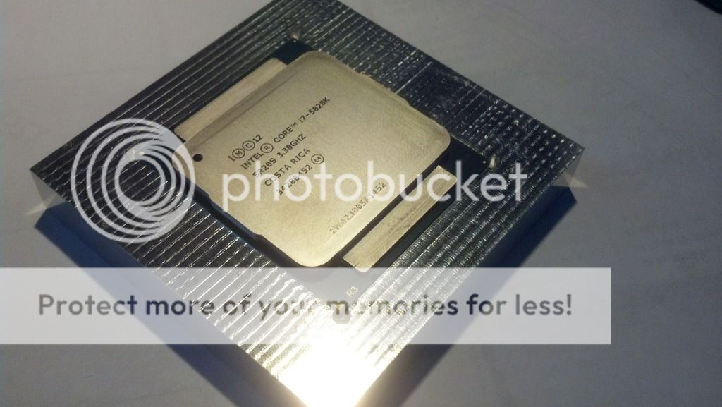

I am setting a goal to have that lapping machine testing by the end of the day
nateman_doo
  • Total Posts : 10493
  • Joined: 2008/01/16 16:16:54
  • Ribbons : 52
Re: Request for 2011-3 Nateman CPU Block. 2015/03/20 11:13:20 (permalink)
Here is said goal:
nateman_doo
  • Ribbons : 52
Re: Request for 2011-3 Nateman CPU Block. 2015/03/20 11:14:51 (permalink)
Just in time as something has arrived in the mail:
nateman_doo
  • Ribbons : 52
Re: Request for 2011-3 Nateman CPU Block. 2015/03/20 13:26:17 (permalink)
A test with simple polishing compound:

That video was simply a proof of concept that it could work.  There are improvements that must be made for rigidity, and perhaps the rings need to be steel (or weighted down by steel)

A prototype has been built.  Currently out for testing.  I could possibly make another prototype for you.
nateman_doo
  • Ribbons : 52
Re: Request for 2011-3 Nateman CPU Block. 2015/04/11 21:42:16 (permalink)
Just a quick picture of a functioning prototype:
 and my 4 year old's scribbles.
