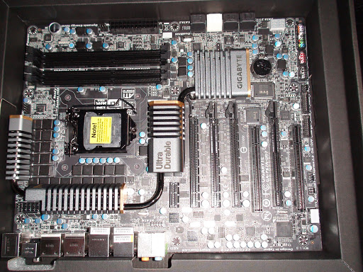

Have you considered doing something like this
http://www.performance-pcs.com/catalog/index.php?main_page=product_info&cPath=59_971_241_589&products_id=30442
You could do something similar but in a single block config(or split) And this eliminates any possible issues for 3 way SLI users, only downside is you don't regain the top x1 slot.

The difference is the Gigabyte motherboard, doesn't have some components in the gap that make the choke point that EVGA's board does.  I have to pull every trick in the book I can to get water to that chip.
See the highlighted annoyances:

At first glance I though the fluid didn't flow to the lower chip in that block, but it appears it does.
Hopefully you figure something out
