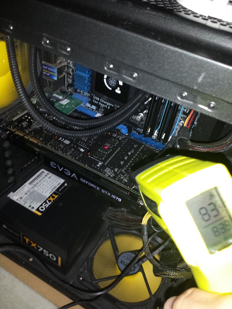

I decided to buy a cheap temperature gun (Ryobi IR002, Home Depot) and test my card to see what kind of temps I was getting after the new BIOS:
After running 20 minutes of the latest Furmark release, I started taking measurements while the stress test was still running.
-Highest reading I could get from the back of the board was 84C. (83.9) No thermal pads. Just the new BIOS.
Just thought I would share this for others who have non-back-plate boards.
Edit: will post pics once photobucket is done with their "maintainance".
This is 20 minutes into Furmark and still running. It only seems to let me use one photo, so here is the hottest measurement I found anywhere on the card:
post edited by z1nonly - 2016/11/05 11:58:31

    FWIW, The gun has an accuracy rating of +/- 5 degrees And I think it was reading on the high side.
    Every time I shot the GPU I was reading a few degrees higher than the number displayed on-screen from the built-in sensor.

    Um, no.
    The internal GPU sensor was showing 68 and when I shot the back of the card right where the GPU is located....The gun was reading temps in the low 70's. So, while the accuracy of the gun may be in question, it consistently showed GPU temps a little higher than the reading the internal sensor was sending to software.
    I suppose you could argue that the GPU sensor was ALSO faulty and reading very low, or that the area on the PCB behind the GPU does the opposite of what the rest of the PCB does, or that the gun was changing calibration from reading high over the GPU to reading crazy low behind the VRM's, chokes, and VRAM chips....every single time I alternately read the different areas?
    But none of those scenarios are likely.

    I agree.
    That's why I measured the back of the GPU with the gun and compared the gun's measurement to the internal sensor's readout.
    Gun measurement on the back of the board was  inaccurately high compared to the internal sensor on the GPU. (Even then it was close enough to know that I don't need to freak out about my VRM or VRAM temps.)
    I didn't check, but I don't recall Tom's test showing any great discrepancy between GPU's internal sensor and their FLIR readings.

    Lol, I just noticed OP isnt even taking temp readings of the VRMs, as you can clearly see he's taking reading of the VRAM. Quite funny.
    If the VRAM is running at 83c then the VRMs are well over 100c+ easily. He's 1.5 inches AWAY from the VRMs and as we see in other thermal spectrum pics, the VRM section is significantly hotter than the VRAM area.
    post edited by pawelblyskal - 2016/11/05 11:43:45

    Lol, indeed. -Starting to suspect a troll....

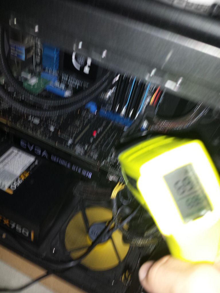

    I noted that I could only post a single pic in my OP. (Not sure why) So I posted the hottest reading I could get off of the card while it ran Furmark (20 minutes at this point)
    I measured temps all over that card. I did not feel like taking pics of every square centimeter of the  card. the readings I took pics of are THE HOTTEST TEMPS FOUND....ANYWHERE on my card. (Other than the GPU which was in the low 70's...but that has a built in sensor so...)
