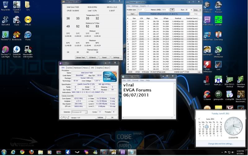

Re:I want 4.2 ghz on my 920.. help me get there.. 2011/06/06 19:21:51 (permalink)
I've lowered my vcore to 1.25 for 4.2, how would I go about getting higher gflops
Do you think that is any good?
I've done a 4.3 submission to the club!!

Re:I want 4.2 ghz on my 920.. help me get there.. 2011/06/06 20:12:01 (permalink)
I don't think you will get any better Gflops than 54.x. It is right on par for the max near your OC, W/920.

Re:I want 4.2 ghz on my 920.. help me get there.. 2011/06/07 07:35:01 (permalink)
Can you please post your voltages. I'm curious because my chip seems to be rather funky, it's been at 4.2 for about 3 years and never blue screened except in linx
v1ral
  • Total Posts : 566
  • Joined: 2008/07/23 01:11:26
Re:I want 4.2 ghz on my 920.. help me get there.. 2011/06/07 08:56:01 (permalink)
vcore for.that ss is at 1.25
