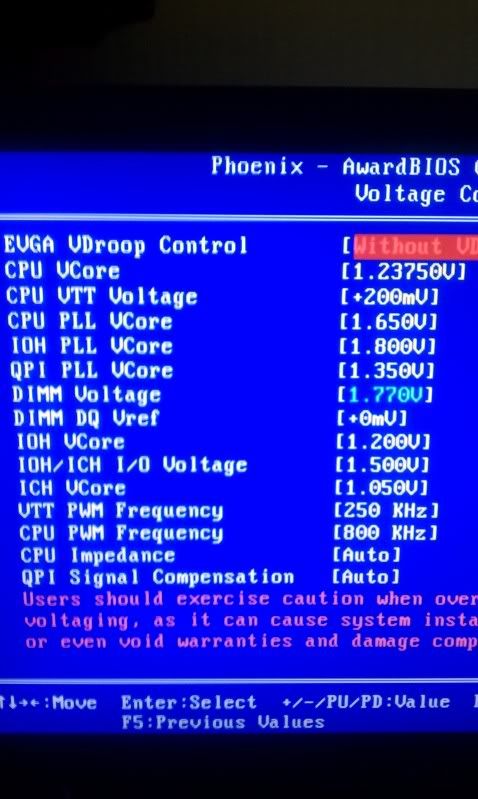

Re:I want 4.2 ghz on my 920.. help me get there.. 2011/05/16 11:37:34 (permalink)
roger i understand sgt.
ive attached a photo of 201 baseclock with vdimm way high.. i passed about 6 passes then got errors. should i go straight to 1.4x vcore.. yeah.. dont tread on me about my 13 pages of failed attempt.. i seek any kind of help.. i gives a flying hoohah.. one person says i ned new ram.. another tels me this and that.. sorry but i taken offence to the belittlement of my thread... i take all suggestions as they.come.. one.. the water block is a given. the more i.go.through.with.this.venture.. ppl say i gotta get this and that.. i am just trying what works for me
i can pass linx 20 passes for sure but with 2:6 ratio to the ram...just trying to tighen them... if i can joij the club with 2:6 ratio then so be it
vdimm for 2:6 was at 1.75..
post edited by v1ral - 2011/05/16 11:55:42

Re:I want 4.2 ghz on my 920.. help me get there.. 2011/05/16 11:52:43 (permalink)
LOL, I'm not treading on you. But you gotta at least give it a try. I would say go down on dimm voltage also.You will not hurt the chip with mid 1.4's on the v-core.1.77 is way too high on the dimm voltage. Just lower that to maybe 1.66 or so, then give it a shot.

Re:I want 4.2 ghz on my 920.. help me get there.. 2011/05/17 09:44:11 (permalink)
Still too high on dimm, IMO, and STILL too LOW on v-core, LOL

Re:I want 4.2 ghz on my 920.. help me get there.. 2011/05/17 18:03:23 (permalink)
Okay here is a screen shot for proof...
Edit.
Vcore 1.325
VTT +0 or 1.2 volts
post edited by v1ral - 2011/05/17 18:05:29
