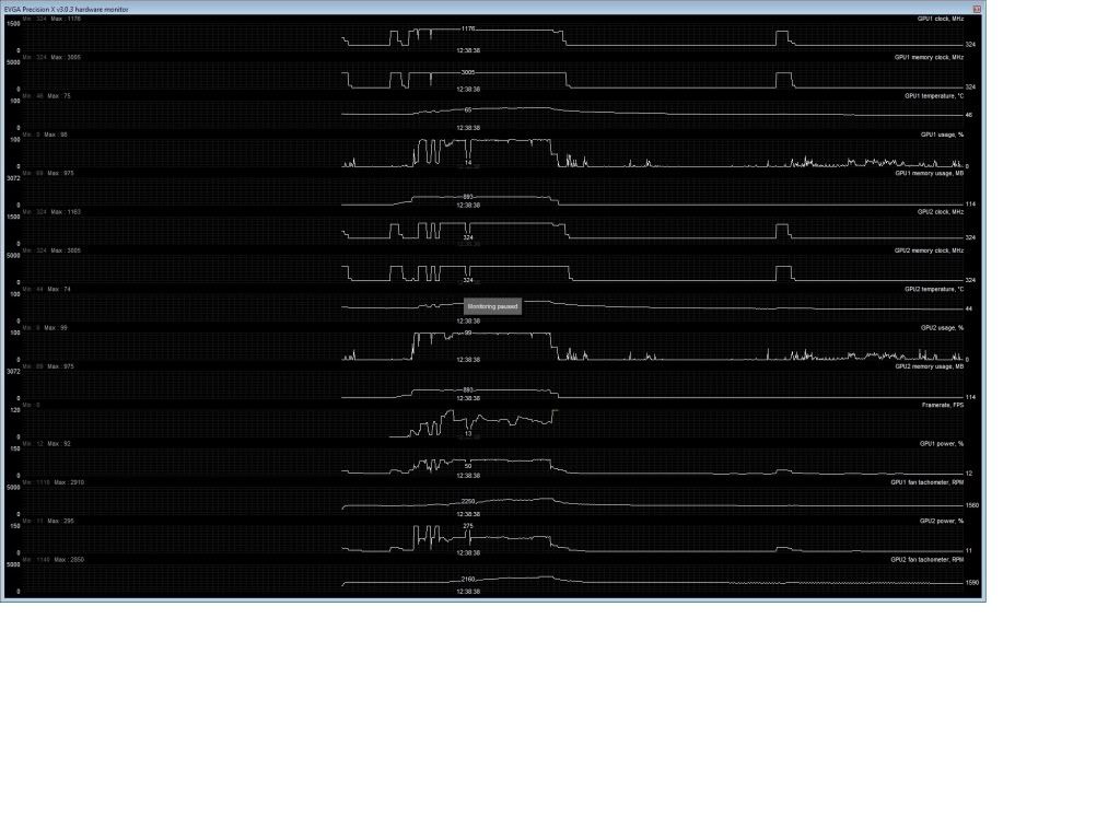

I just got two GTX680 FTW 4GB SLI and have been running some benchmarks and trying a few games.   I've noticed occasionally that the GPUs (one a at a time) will sometimes downclock to 324 Mhz for a few seconds while the power will show 275%.  It's not just one GPU doing this, it will often go back and forth between the two GPUs every 10-15s.  I'm farily certain that it is not downclocking due to high temps because it will do this at any temperature.  The highest temp I have ever seen on either card is 78 C.
The strange thing is that I don't always see this issue.   Once I noticed this issue while playing Skyrim because of the stuttering when one of the GPUs down clocked every 10-15s.   I exited the game and restarted and it worked fine for several hours.
Any ideas as to what the problem could be?   Drivers, defective GPU(s)?  I'll probably start by testing each GPU separately to see if I can narrow down the issue.  The cards are great, but the periodic downclocking ruins everything when it is occurring.

    I had EVGA Precision 3.0.2.   I've updated to 3.0.3 but I still have the same problem.   "Frame Rate target" is not checked.
    I just tried running the Heaven 3.0 benchmark a few times after updaing Precision and rebooting.  The first few time I started up Heaven one of the cards would downclock to 324MHz for a few seconds periodically, but now it's running fine without any down clocking.

    After I shutdown for a while I see the problem.   The monitor shows the power usage of GPU2 go up to 275% several times while the clock on GPU2 drops to 324MHz.
    I'll try swaping the card and see if it follows one of the GPUs.

    I swapped the card and GPU1 now shows the power shoot up and clock rate drop periodically under load.   I'll send the card back.

    Newegg has already approved my RMA for replacement so I'm sending it back.  It's definitely a problem with the GPU.   I ran each GPU independently and one of them works flawlessly.   The other GPU has the downclocking/power issue under load which causes very low frame rates.   The problem does seem to be worse if my PC has been shutdown for a while before running a benchmark.   If I shutdown for 30 minutes, power up and start Heaven, the thing is spiking and stuttering every 10-15 seconds like clock work.    It gets better after a while but I still see spikes even after running Heaven or a game for an hour.

    RMA.  The replacement I received works.   With so many cards having this problem, I'm a little conerned that working cards could start doing this in the future.
    Precision shows the power shoot up to 275% when it downclocked under load.   Seems like something wrong with power monitoring.
