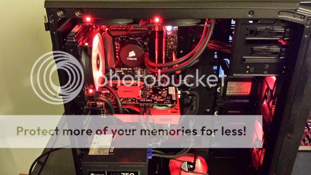

I decided to try this before going for a custom water cooling loop, plus full cover blocks for these cards aren't out yet. Here's what someone looking to do this may run into: 1. The fan on the G10 bracket blows air over the right side of the GPU, the VRM's are on the left side of the GPU. So I removed the thermal pad from the ACX cooler covering the VRM's and placed it onto the VRM's. Then I mounted some heatsinks I had on hand to the VRM's. 2. When installing the PCI-E power connectors, the space between the G10 bracket and the 970 is limited. Installing the connectors is fine but to push the latches down to remove the connectors may prove challenging since the latches are really close to the G10 bracket. 3. NZXT branding in my mostly Corsair system, lol, not really an issue. As for the H90, I am using a Corsair SP140 fan in push, I am not using the provided 140mm fan. Planning to do some testing and I will update this post in the next day or two. I can say this, idle temps are lower and a quick run thru the Heaven benchmark shows about 20 degree lower temps vs. the ACX 2.0 cooler at 40-50% fan speed at full load, while remaining nearly silent!

Hi, im getting ready to do this except with a ACX 980 SC. did the 970 have a heat spreader under the EVGA fans?
iF so did you go with a copper shim or did you remove the spreader?
are you still happy with your results? any thing you would change in hindsight?
thanks.

Finally got around to testing this setup. Test system: Corsair 730T Case - (2) AF140L Intake, (1) AF120 Intake Intel I5 4690K CPU @ 4.5ghz - 1.185V - Corsair H110 Cooler - SP140 fans in push Asus Maximus Hero VII Motherboard Corsair Vengeance 2400mhz RAM 2x8 GB Kit EVGA GTX 970 SC Crucial M4 64 GB SSD - OS Drive Samsung 840 Pro 120 GB SSD - Media Drive Samsung 850 EVO 500 GB - Game drive Corsair HX750 PSU Heaven Benchmark Quality - Ultra Tesselation - Extreme Anti-Aliasing - x8 GTX 970 SC ACX 2.0 Cooler Boost Clock - 1342mhz (stock) Power target - 100% Fan Speed - 30% - Max Temp 68 degrees Fan Speed - 40% - Max Temp 62 degrees Fan Speed - 50% - Max Temp 59 degrees GTX 970 SC ACX 2.0 Cooler Boost Clock - 1501mhz (+25mv) Memory Clock - 3600mhz Power target - 110% Fan Speed - 30% - Max Temp 71 degrees Fan Speed - 40% - Max Temp 64 degrees Fan Speed - 50% - Max Temp 61 degrees GTX 970 SC - Kraken G10 - Corsair H90 Cooler - SP140 fan in push Boost Clock - 1342mhz (stock) Power target - 100% Max Temp - 44 degrees GTX 970 SC - Kraken G10 - Corsair H90 Cooler - SP140 fan in push Boost Clock - 1501mhz (+25mv) Memory Clock - 3600mhz Power target - 110% Max Temp - 45 degrees So basically there is a 15-26 degree drop when cooling with the G10/H90 combination versus the ACX 2.0 cooler. However, the real benefit is the noise reduction. The ACX 2.0 fans on 40-50% especially when running in SLI are annoyingly loud. This setup is quiet! Btw my ACX 2.0 cooler was only touching 2 of the 3 heatpipes, its a known issue, just thought I would add that.

Big Shadow I decided to try this before going for a custom water cooling loop, plus full cover blocks for these cards aren't out yet. Here's what someone looking to do this may run into: 1. The fan on the G10 bracket blows air over the right side of the GPU, the VRM's are on the left side of the GPU. So I removed the thermal pad from the ACX cooler covering the VRM's and placed it onto the VRM's. Then I mounted some heatsinks I had on hand to the VRM's. 2. When installing the PCI-E power connectors, the space between the G10 bracket and the 970 is limited. Installing the connectors is fine but to push the latches down to remove the connectors may prove challenging since the latches are really close to the G10 bracket. 3. NZXT branding in my mostly Corsair system, lol, not really an issue. As for the H90, I am using a Corsair SP140 fan in push, I am not using the provided 140mm fan. Planning to do some testing and I will update this post in the next day or two. I can say this, idle temps are lower and a quick run thru the Heaven benchmark shows about 20 degree lower temps vs. the ACX 2.0 cooler at 40-50% fan speed at full load, while remaining nearly silent!
I am looking to do this as well on my 970 SC ACX 2.0 cards. How much space do you need between the cards? I have the MSI Xpower AC X99S board, so there are about 3 full PCIe slots between my 2 16x slots, hoping that is enough to put two of these in.

When I did this, the idea was to use (2) of these set ups, one mounted on the back and one mounted on the bottom. The bottom is a 120mm fan mount and I was planning to use like H55's or something. But then I had some monitor issues and decided to stay at 1080 and a single 970 is fine for my uses. To your question, 1 space would work, it all comes down to how your going to mount the two rads. Look in my pic, see the two empty PCI-E bracket slots in the case, that's where the second card was.
