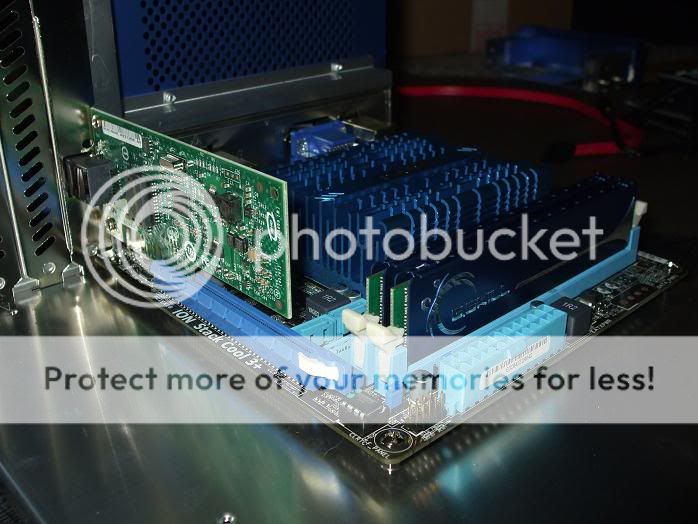

Side pic, showing sleeved FP Connector, and Gigabit CT Desktop Adapter

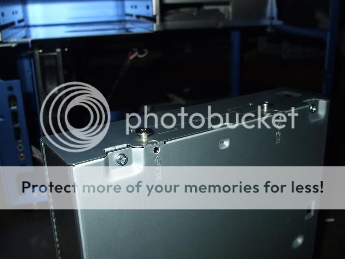

Fitting the 5.25" Drive into place
The newly mounted AT3IONT-I; on the new motherboard tray.
After making all connection's; and completing this part of the assembly.

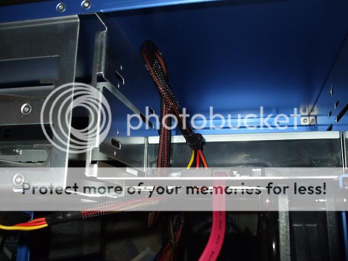

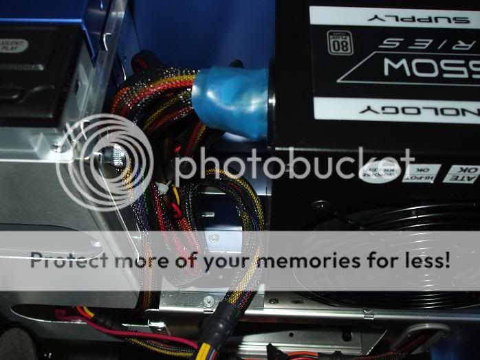

Stuffing the remaining PSU connector's, and a large majority of the 24-pin connector cabling; up into the space behind the power supply.

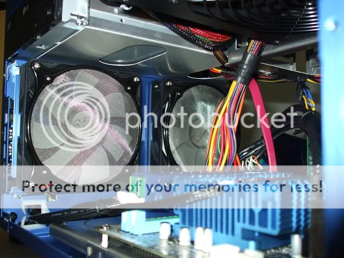

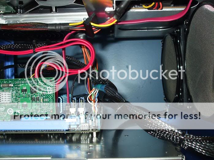

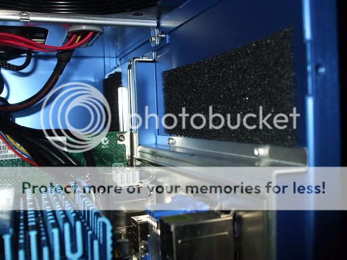

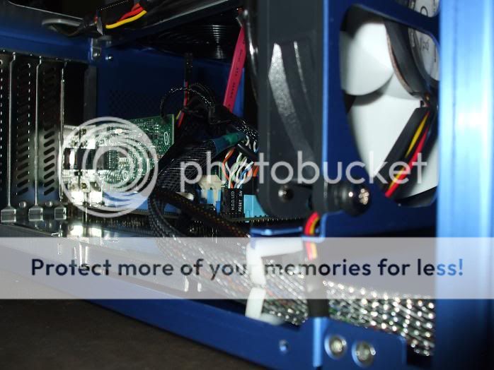

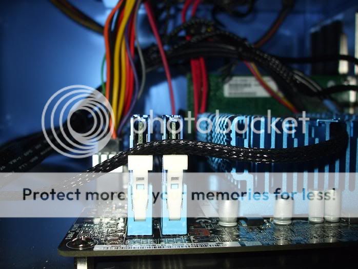

    Just finished adding in the modifications; I discussed in my previous post. I've also added some mini heat sinks to a few spots; to potentially offset damage caused by heavier usage. Aside from the one on the Gigabit CT Adapter's chip; I doubt any of the others, will prove very effective. I put them in anyway

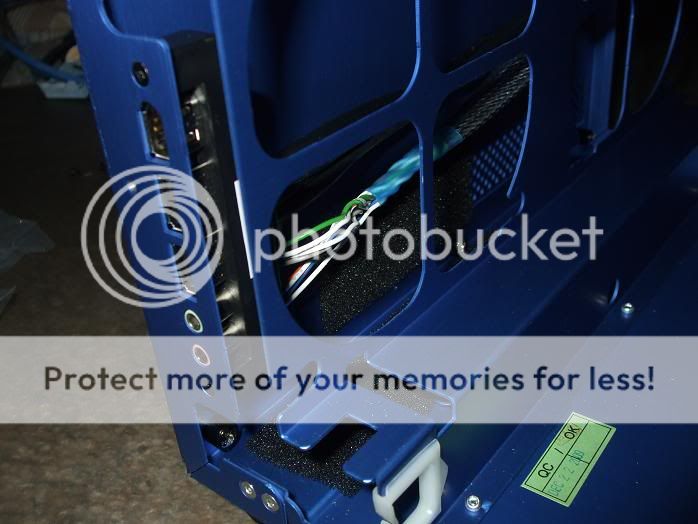

    Back of the chassis, showing the new mesh inside the PCI brackets; and the mesh I placed over the 80mm fan intake. The inside mesh over the I/O plate; isn't really visible here.
    One of my Heatsinks up front, and a nice look at the RAM.
    The mesh installed; no more easy airflow there
    The Thermal sensor from the 120mm push fan; which is plugged into the CPU fan header; the other 120mm being plugged into the power fan header.

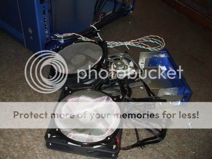

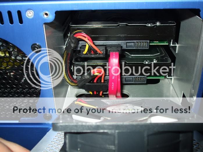

    Re:[Worklog] DHCP Blue Box - HDD's in 2010/06/22 18:28:15 (permalink)
    Just got my hard drives in; and getting ready to install the new OS. Nice drives; but, ran into a minor problem with the chassis. As you can see; the fan is oversized, for the space; and the HDD connector's just barely fit. I had to remove the fan guard to get it in there; and still barely squeaking by
    Got some zip ties from one of the local PC stores; so I could tie everything up properly ..Just enough to do the job

    Re:[Worklog] DHCP Blue Box - operational; less one drive. 2010/06/26 20:17:44 (permalink)
    Just a little update.. I was having issues with my drives and ubuntu; as some of you may already know. These have been resolved..
    ..I installed Windows 7 Pro
    So.. just a few pic's, of my HDD fan modification; that I needed to do, to get proper cable placement. ..no crunching now.
