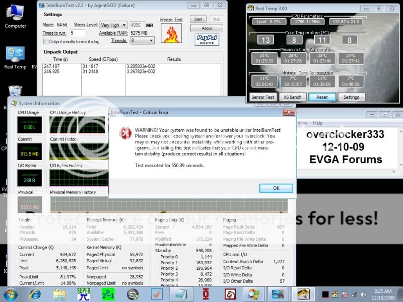

Ok all of you LinPack fans... mind explaining this one???
Completely stock settings... absolutley no overclock... 10*c chilled water coolant and it says I have a cooling porblem?   ROFL!!!
It would seem that all talk about LinPack not working with HT is true.

Reconfigured my overclock with more emphasis on BCLK instead of Multi, which gave me a bit more performance on the cpu end of things. Ended up bumping the clocks up a bit too while I was at it, but I think this is the end of the road for me because load temps are higher than where I'd like them to be. This will definitely be my benching overclock only.
Core i7 (975 EE)  Batch# 3910A348
CPU clocked at 4524.7 MHz
Voltage: 1.517
Idle temps: 37,34,37,34
Load temps: 88,84,83,79
Gigabyte Z77X-UP7

Very nice run jdookie !

expedision
Thank you! Now I need to work on tweaking this clock. I'm still using the bare minimum uncore frequency, so if I can figure out how to start increasing that without increasing temps, I think I can get more performance out of it.
As of right now, I'm using a QPI PLL VCore of 1.40, and VTT of +250. Do you think if I go up on either of these I might be able to decrease Vcore at all??

Re:*Club i7 Stability Continuation* 2009/12/10 16:31:04 (permalink)
It all depends on your cpu. Keeping your ram speed down will help (2:8) and tighter timings.
