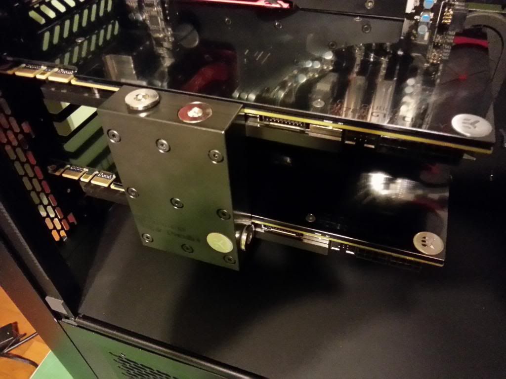

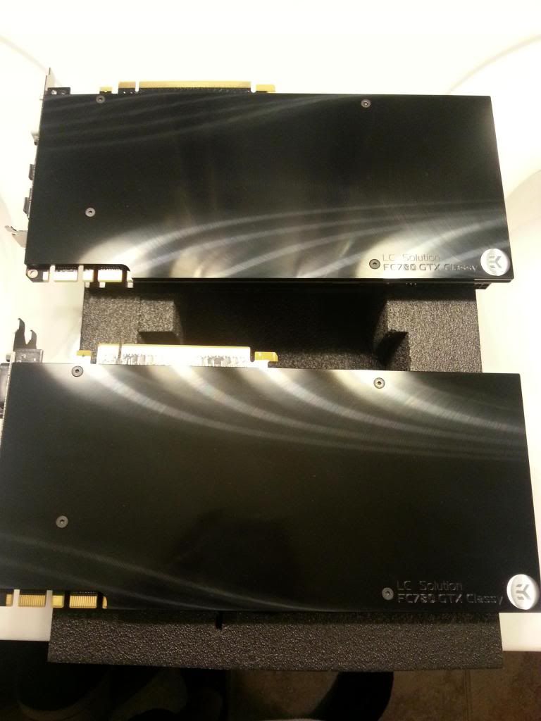

At this time, I do not have a way to test out the temperatures, as my case is too small to install everything.  The new case will be here soon, hopefully.
Second note, installing the EVGA back-plate does work, but the M3x6 screws that secure the back-plate to the waterblock on grab in for about a turn and a quarter. The head of the screw is also larger than the screw hole for the back-plate, so the head of the screw will not be flush.  Also, if you can only find silver screws, an issue I have, they will not blend in at all. Lastly, out of the 11 screw holes on the EVGA back-plate, only 5 are utilized with the EKWB waterblock.  It does feel very secure either way.
It only took me about 1/2 an hour to install everything, as I have never done this before.  I know a lot of suggestions come out for the way to apply the thermal paste, but I followed EK's method of the star pattern, as I seriously followed the instructions directly.
Attaching a few pictures.  I found a lot of thermal paste under the ACX cooler..  kind of Globbed on there like most others are reporting.
post edited by Scarlet-Tech - 2014/02/17 05:52:50

    Interesting :) So what screws did u have to use to get it mounted together? Did u just use those who came with EK Waterblock?
    Please post some more pictures :)

    No,  they are M3x6 screws that you can order from Lowe's or anywhere like that.   I am going to see if I can find some with either a slightly smaller head,  or ever so slightly longer, just so it can grab a little more threading.
    EK does supply plastic washers,  that are meant to help prevent scratching the PCB.   If the are between the backplate and the PCB, the screws won't reach the waterblock.  That is why I am hoping to find slightly longer screws.

    5 per card total.   If you can order from Amazon,  they are all over it.   I am going to try a different screw head,
    http://www.amazon.com/gp/product/B0037YC982/ref=oh_details_o00_s00_i00?ie=UTF8&psc=1
    I want to see if those can dig in a little deeper.
    The EK Block takes 10 total screws.   5 do not attach to the backplate at all,  and they are installed prior to installing backplate.   The other 5 (listed above)  are the ones you need to secure the backplate to the block :-)

    Between the two, the EVGA backplate looks MUCH nicer in my opinion.   Since the backplate is more for aesthetics anyway (I seriously doubt either provides any real cooling advantages over the other, I plan on sticking with EVGA's backplate.
    Here are mine:
    Let us know how the Hex M3X6 screws work out.  The fact that the heads are tapered underneath (rather than pan heads) should help them dig a bit deeper and grab a bit more of the EK block's threads.

    Far left, M3x6 that I bought.  Mid Left the one from EK.  Mid right, EVGA Backplate screw.  Far right, EVGA Stock Screw.
    Any more questions, left me know.  Sorry for the crappy picture, but I am tired and it is late.
    P.S.  New Pictures up top!
