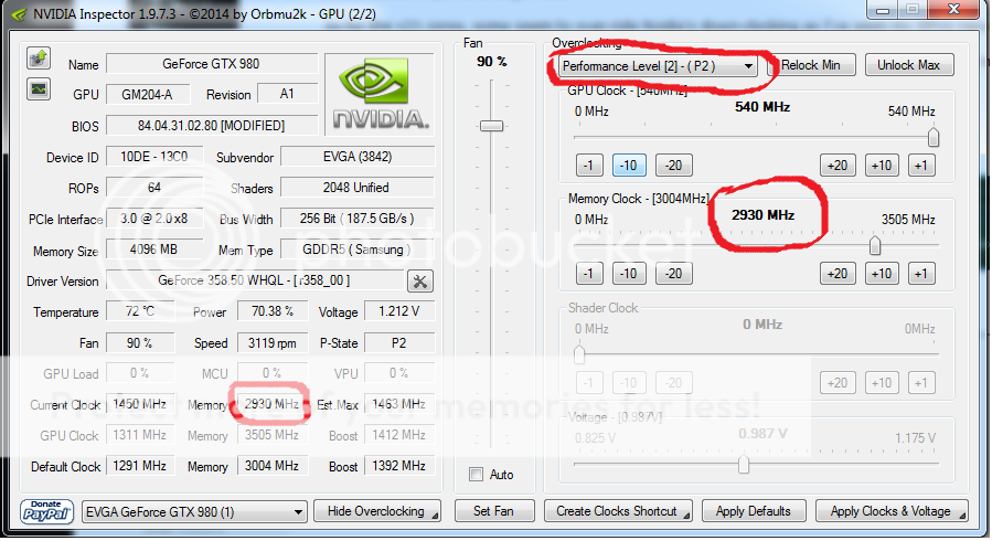

How are you guys going about lowering the P2 state? I've under-clocked the memory of my cards to -501 ( the lowest precision will allow) and still get errors.
As for grandpa's questions, it all seems to be about stable memory, Fermi and Kepler have memory at 6008mhz while Maxwell is at 7010mhz
My best guess is that Nvidia knows that 7010mhz is too high and unstable for compute work and Down-clocks it to 6008 for it to work, something that that more stable memory on Fermi and Kepler don't need as they are running at a lower memory speed to begin with.
As for the x21 cores, some seem to over-ride Nvidia's down-clocking as I've seen my GPUs reporting the memory running at 3505mhz (7010 effective) compared to the down-clocked and stable 3004 (6008) that the x18 are running at
all in all it seems to be the stability of memory at that speed, and it not downclocking to 6008 memory speed like the x18 units do. (or not needing too in the case of Fermi/Kepler)
also as mentioned earlier, the P9704 work does seem to down-clock to 6008 as I have one now, anyone with other X21 core units that can double check the memory speed that they are set too?

Use Nvidia Inspector http://www.guru3d.com/fil...nspector-download.html

thanks, I'll drop it way down to start and creep it back up a bit if needed, as it doesn't seem to affect the TPF or it's P0 state that I'd be running in for games, I may just leave it fairly low in fact.

I do not think Presison X will change the P2 state memory clock you need to Install Nvidia Inspector and look at the P2 state clocks I will bet it says 3004 which is 6008Mhz.
Is it ok to have Precision running ,while using inspector? Didn't know if they might conflict. Thx!
I have used them in tandem before and it appeared to work ok, I did not notice any problems with the set up but I found it easier to just use Inspector so I no longer have Presision installed so I can not answer that for the latest drivers.
